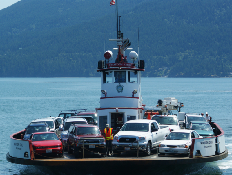

So my cameras are a bit involved, and have a LOT of them since I am a Solo traveler. I deal with tucking in on a SMALL 20 car ferry with narrow lanes. Campsites are easy compared.

- 1 front grill (again a ferry issue, to see the other persons rear bumper, we have to be 8" away maximum - talk about tight),

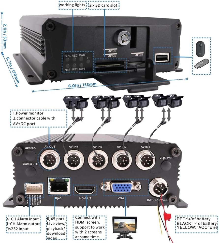

To run all of the cameras, I have an Eight channel HD MDVR which records all of them at the same time. It sends selected video to a monitor in the cab for when I am moving, and another monitor in the lounge/bedroom for parking. It also sends the video out to me remotely.
But for those math inclined, yes, I have more cameras than channels. So I designed and built a custom camera switcher that selects which is in use for the current situation. I'll add a diagram to show more of what I have later on.
