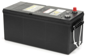

The Bus itself has a huge 97lb Group 4D lead acid battery that I just replaced. Currently the entire Bus (engine, lights, cabin) run off of it.

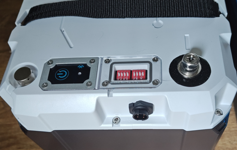

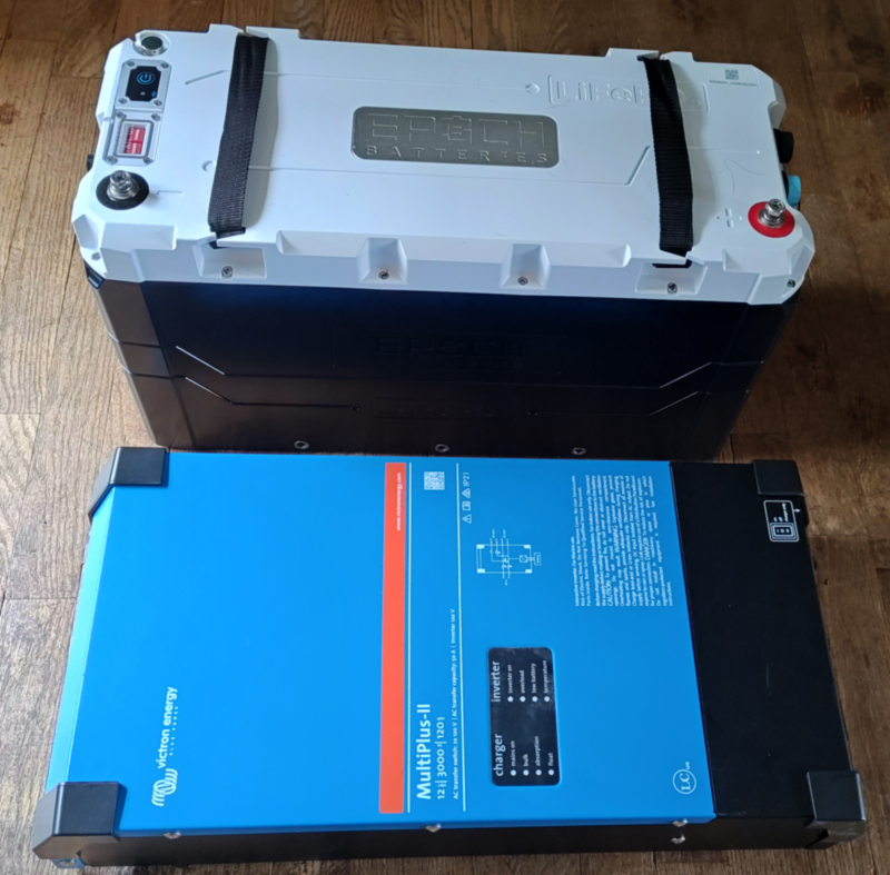

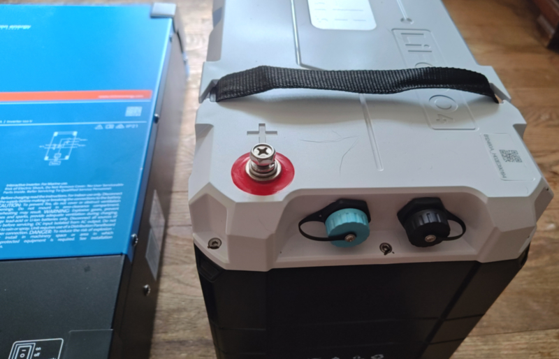

Quote from Alan K. on 2024-08-25, 7:04 pmThe battery arrived Friday the 23rd ahead of schedule, and I am VERY impressed with the build quality and features.. esp for the price. And yes that is a Victron Inverter/Charger next to it. Note that it is Screwed together not glued, and all the comms are IP rated connectors. The metal plate in the center is also not just decoration, it is part of a very large heat sink attached to the BMS system inside. What a Tank ..
